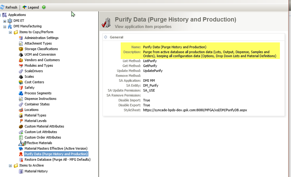

    Hello friend,
    actually if you go in the Syncade admin menu and open up the DM tool there is one option to clear production data like orders and inventory but leave the configuration of the system alone.
    Comment
    • #3
      Hi Charlly! Is this what you're talking about? Purify Data? I feel this would actually remove ALL of my information. I'm only looking to bulk-close orders in our lower/DEV environment.
